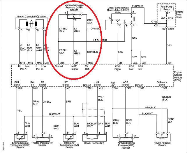

Tu mas aj schemu zapojenia.<br />Je to z Evandy ale princip je ten isty.
