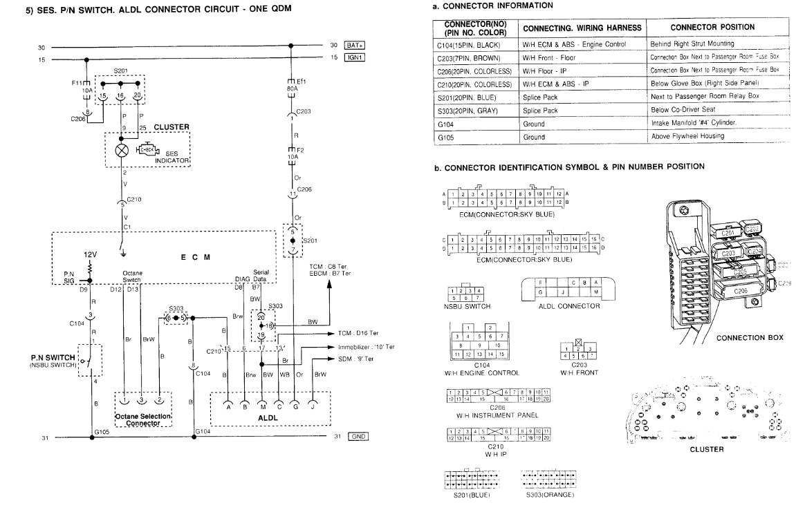

Pin
Number Pin
Name Description (may be empty)
A GND Chassis Ground
B L-Line Engine diagnostic, ABS (8KBaud Serial Data, not always present)
C AIR may be n/a
D SES-LAMP Self-diagnostic lamp (may be not available)
E K-Line K diagnostic line (160-Baud Serial Data)
F TCC may be not available or +12V
G fuel pump control (may be n/a)
J K-Line Airbag diagnostic (8KBaud Serial Data)
